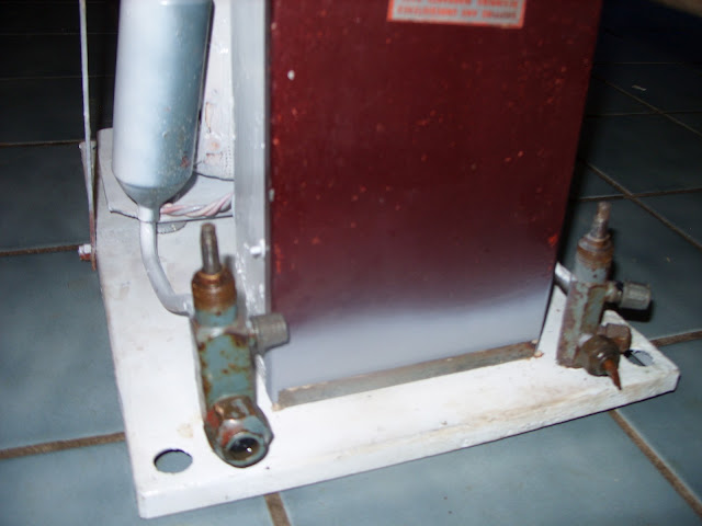

Learning some more. these are charged by standard type ports. The ports are opened by valves sealed under a screw on cover.
When new, these valves are shut and the unit is precharged.
After an install, these valves are fully opened CCW all the way. At that point the charging ports are sealed. (no shraders in them)
To charge, turn these valves in about one turn, CW. This will expose the charging port to the internal refrigerant lines.
They make a square handle for the charging valve. Previous owners had used vice grips, please dont ruin the stem!
If you find them stuck or rusty, then I sprayed with KROIL and got them moving. There is no reason to go more than one turn CW, why risk the stem seal?
There is a third port with shrader valve which I suppose is for monitoring system pressure.
Always charge on the low pressure suction side which is the large diameter tube.
When your finally done, put grease on these and put the covers back. Make sure you turn the valves back all the way CCW. I noticed someone had used some teflon tape on these cover threads.

picture showing the condensing unit and valves on front.
I removed the bottom and sealed the compressor with PL Premium and fiberglass tape
Coated all the exposed metal with PL and painted it white.
Picture shows the stem caps removed and the various connection and charging ports. Suction port on left, pressure port on right, cooling mode.
I ran the unit and it works when the purple and white wires are energized.
Short black capacitor is the start, tall is the run.
Center pressure switch detects if pressure is too high and will turn off compressor. (purple wire runs to it)
Black wires goto reversing valve. Blue wire from harness attaches to central black wired terminal on relay.
I sucked in using a vacuum pump about 6 ozs of mineral oil, then the reversing valve got stuck in heat mode. So rap lightly on its end and it freed up back to cool mode. I upended the unit to do that and help oil get in past the strainer can in the refrigerant line so who knows.
The new electronic control actuates that reversing valve when turning the unit on to keep it from freezing up.
I was thinking that is a nice idea and might be a good idea to create a circuit to do that when it is turned on. Although I am not sure how to achieve that or when it should take place in the start up sequence.
This compressor was replaced in 93
There are 3 accumulator strainer - filters? in the lines.
One on top and 2 lower. I was wondering if the top one was added when compressor was replaced.
I also had to resolder one of the water tube ends. I used silver solder. I also removed the plastic tube that holds those ends on if they break loose which could then flood the bilge. To remove squirted a lot of dish soap and water mix into the cooling tubes and managed to pull it out. I was thinking perhaps a nylon tie to the hose clamp or just dont worry about it. It was broken anyway and did not want to heat it when soldering and have it melt inside the cooling tubes.
