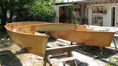

Hey, Terry-- I'm a troublemaker by nature, I guess. The little cat I designed and built, Slider, is a 16 footer that flies in the face of accepted wisdom, which is that you sit on top of a cat that small. The great trimaran designer, Jim Brown wrote a piece for Cruising World in which he predicted that tiny multis, like the Windriders he had design input into, were the Next Big Thing for small boat sailors. He also opined that cats weren't going to be good small cruising boats, because you had to squat on a trampoline. Now Slider is too big and heavy a boat to cartop, but you don't have to squat on a trampoline. It's the most comfortable boat I've ever sailed, in fact.
But... not a cartopper.
I know there are lots of folks who don't have a place to park a trailer, So my next project is a cartopper cat.
It will knock down so it can be carried on a roof rack and put together quickly at the beach. Unlike beach cats, there will be ergonomically correct seating inside the hulls. Compared to beach cats, the rig will be modest and simple-- about half the sail area of a Hobie 16. It's aimed at those who could be content with a modestly rigged 14 foot open monohull sailboat-- but who are willing to try something a lot more comfortable and stable.

Nice! I have a design for a cat of similar size, that I have been eyeing for some time. I know I will have to get a trailer sometime and I have space for one but I'm just puting off the inevitable. I am slowly but surely being lured away from the superlight canoe and kayak scene. I have to bear in mind that, one day I will not be able to get into the damn things, tempus fugit and that kind of stuff. So I will be forced to either build or buy a boat that won't car-top and that will be that. Or give up boating - not bloody likely!
