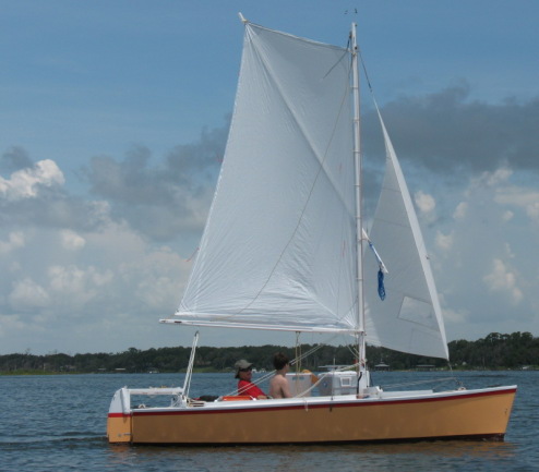

I'm also of the opinion that one should start small, but that need not be unambitious.
Here's a snapshot of a little beachcruising cat that I designed and built. I am not a naval architect. Despite this, the boat has continually surprised me with how well she sails.
On the other hand, I've been a sailor for over 30 years, built several small boats, and been a student of boat design for most of that time (the first boat I built was an adaptation of a scow described by Chappelle. It was a disaster. It was not Howard's fault.)
I spent several years thinking about Slider before I began to build and 19 months scratching my head over every detail.
The reason for the whole exercise was that I wanted a boat for which no designs existed. Had I been able to find a design by a trustworthy designer for a tiny beachcruising cat with comfortable in-hull seating and a low-tech sail plan, I'd have been a fool to spend so much time trying to duplicate the work of a more gifted and experienced designer. But the kind of boat I wanted did not exist, so far as I could tell, and I looked pretty hard.
That to me is the most rational of reasons for attempting a design as an amateur-- that it's something new. The pioneers of multihull design were rarely trained naval architects; they were breaking new ground.
On the other hand, there are those who find boatbuilding more interesting than sailing, and more power to them. If you aren't one of these, and you're not breaking new ground, get plans from a good designer. You'll be sailing a lot sooner.
Ray
http://slidercat.com

Thanks, Trev. I really appreciate the kind words.
I don't mean to say that there's anything wrong with designing a boat that doesn't break new ground. My point is that a person should decide what is more important to him -- designing for the sake of designing (nothing wrong with that) or going sailing.
Designing a boat is like putting together a puzzle from scratch-- not just fitting the pieces together, but making the pieces, too. There's a great deal of fascination in that, even if the boat is like a thousand other boats.
If one is designing for the pleasure of designing, it seems to me that pleasure might be more intense if the boat being designed is different in some significant way from other designs. Of course, this is a riskier form of entertainment, as there may be some very good reason why no one is building boats of that unique sort. Failure is definitely an option when breaking new ground-- but it's also possible when one is re-inventing the wheel.
There are thousands of designs for open skiffs in the 14-18 foot range. Some are brilliant, like Dobler's 16 footer, or Michael Storer's Goat Island Skiff. I wouldn't be tempted to draw a similar design, for several reasons. For one, it is very unlikely that I, an untutored amateur, would be able to design a boat as good as the boats designed by gifted and experienced professionals with a lifetime of experience in both design and sailing. Why cheat myself out of a superior boat, just so I can say, "It's my own design. It's much like a thousand others, but not as good as the best of them."
In a way, I suppose this is like the dilemma of the art lover who, late in life, takes up oil painting. He naturally prefers to decorate his living room wall with his own daubs, rather than prints of great paintings. There is absolutely nothing wrong with this, and this attitude is much more admirable than the mindset of some Philistine who buys a painting because the colors match his couch. Still, for every Grandma Moses, there will be a million painters whose work never rises to the level of art.
However, copies of great boats, unlike prints of great paintings, become living works of art themselves, given a little creative input by their builders. They take on that mantle of originality because of the way they are used and maintained and loved.
I'm maundering, so I'll stop. I'm just making a plea for a rational cost/benefit analysis when it comes to designing one's own boat. Like sailing around the world alone, designing one's own boat has an undeniable romantic appeal. But just as so many would-be sailors cheat themselves out of the pleasure of small voyages by holding out for great ones, it may be that some would-be designers cheat themselves out of the pleasure of building a boat of their own, by taking on the ambitious job of designing it themselves.
Ray
