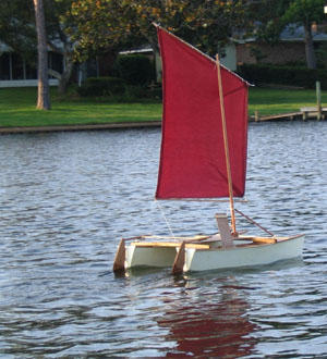

Why are cats not suited to free standing masts - if they can be used in a proa?
Lower mast and less sail area for a lighter boat?

There have been cats built with free-standing masts, and it can work. A cat's wide beam, though, allows a very wide staying base for a conventional or a rotating wire-stayed mast, thus offsetting some of the stayed mast's main disadvantages. As for lower mast / smaller sail area- well, I suppose that rig efficiency improvements could be used that way; still, in practice, a designer who finds a way to make a rig more efficient usually uses that to get more speed rather than a smaller rig.
If you want to try a cat with an unstayed rig, I won't stop you. Just be aware that you're dealing with a platform whose initial stability is more akin to a concrete block on land than to a monohull, which heels with the gusts.

It is possible but it is not very practical and certainly not cheap. It can work very well on the monohull, where good results are possible even with a simple, inexpensive structures without exotic materials. On the monohull, free-standing mast is quite a low stressed structure because hull has a lot of depth to bury must in, deck and hull sides are easy to beef up for carrying stresses from the mast and if the mast is overpowered by sudden wind-gust, boat heels and release wind from the sails.
Multihull on the other hand have enormous form stability and doesn’t heel, That means that rigging must take much larger forces then in monohull. One way to make must more rigid is to enlarge its diameter. That is acceptable in cruising mono, but not in the multi. Having by its nature high performances, multi would be hurt by thick mast.
Other way is to use carbon – expensive and still inferior results to stayed mast.
It is easier to put unstayed mast on the trimaran then on the catamaran. (On the tri, it can be can be buried in the main hull).
On the cat is practically impossible to put un-stayed mast on the crossbeam. It can be only done in the hulls, one mast in each hull –bi-plane rig. These rigs brings a whole new set of specific problems with them. Sails blankets each other, boat is very difficult to keep under the control during the reefing.
As your goal is economical, simple boat I would stay away from bi-plane.
But if you like to experiment try it on something small and cheap:
http://www.ikarus342000.com/DUO425page.htm

Just to agree with what Matt and Milan had to say, the problem with cats is the lack of "bury" out on the mast beam, and the weight of freestanding masts. A proa will have the mast in one hull, where it can be well-supported.
When I was first drawing my little cat, I wanted a freestanding rig desperately. I even built a model with a balanced lug and struts supporting the mast.
But in the end, it just didn't make sense. It might well have worked, especially on such a small scale, where the forces involved were relatively manageable. But in order to have a freestanding mast, it would have had to be quite a lot heavier than a stayed mast, if built of non-exotic materials. Since the basic concept for the boat was a kind of volksbeachcruiser, which ruled out exotic materials, it didn't make sense to have an excessively heavy mast, because pitching is likely to be a severe problem in fine-hulled multis. That much weight aloft was the deal-killer for me.
There are also problems with controlling sail shape in heavy air. Chris White used freestanding masts in his big tri Juniper, but eventually replaced them with a stayed rig, for that reason.
