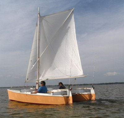

We might all be fishing from sailboats, if the cost of fuel continues to rise. Already, many charter boat captains have been driven out of the business, and a lot of private owners are cutting back. As an example, I have a friend with a 28 foot dual outboard who regularly goes out to blue water to fish. He burns 100 gallons of gas on a typical trip.
That said, big game fishing is a different matter, and if sailing becomes the only way to get to the fishing grounds, and there are no auxiliaries, then at a minimum, tackle will change. Now, big fish can be landed on lightweight gear, because the boats can pursue the fish whenever it takes too much line. If pure sailboats were to become the norm for fishing, then much heavier tackle would be required to land big fish.
I fish a lot from my little beachcruising cat Slider-- in fact, I rarely sail anywhere without a couple of lines out, and I'm rarely skunked. Here's a pic:
When we get a strike, we can go two ways. If it's a fish of moderate size, I just pinch up until we are going quite slowly, and let my crew land the fish. If it's a big fish, I generally heave to, and that's really the best way to handle it-- except that getting under way again once the fish is landed is a little more complicated than just bearing off.
If I were fishing for marlin, I'd need much heavier tackle than I'd need in a power boat.
