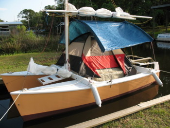

I also favour a small cat.
That is why i have started to build my own MiniCAT5 with the accomodation layout of a Jarcat and hulls similar to Strider.
Keep up the good work, you have been endless inspiration for me, thanks.
Herewith some pics of such a beauties that i got of the net.
I should hopefully be able to post pics in two weeks time of progress made so far.

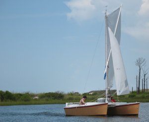

Specific examples 1 and 2
Quote:
Originally Posted by rayaldridge View Post
...My belief is that for open boats under 20 feet, beachcruising cats are superior to beachcruising tris in every aspect except speed. I'd need to see some concrete counterexamples before I'd change my mind.
So, here's an opening mind changer...
You are out sailing down an interesting coastline (lake or ocean) and notice that there's a substantial estuary system where a small river lets into the larger body of water. The area looks to be filled with small islands, noticeable wildlife and dozens of meandering, very shallow pathways into the interior. You'd like to go in there and explore, but in the draft-consuming cat, there's just no way.
You did not bring any sort of kayak, canoe, or inflatable as it would have taken far too much of the available room and the weight of the smaller boat would also have to be considered.
So, you don't get to explore and inevitably pass by the opportunity for a truly rich coastal cruising experience.
The boat shown below lets you beach your craft, demount the amas and rig and turn the main hull into a low draft, easily paddled canoe. The business of exploring the complexity of this estuary suddenly takes on a whole new level of opportunity for the coastal explorer.
It's not just speed advantages, or better performance in light airs... it's a whole open book of potential adventures that are otherwise untapped by such small, cruising multihull craft.
The shot of the canoe being paddled on the lake in fall is the exact same hull as the trimaran on the beach at Lake Powell in the other shot. The trimaran pictured can be demounted right down to an 80 pound, highly responsive and fast tripping canoe that is decked for the elements and very stable.
And this estuary potential is just for openers. How about a multi day canoe trip up the river that created the estuary in the style of the French Voyageurs? Not exactly the type of boating adventure that could be taken with the suggested beach cat.
So, it takes us back to the comment in which one needs to first create the list of needs that one expects from their coastal adventure beach multihull. That list will dictate which kinds of craft are best suited for the person who wants the boat.
Chris
