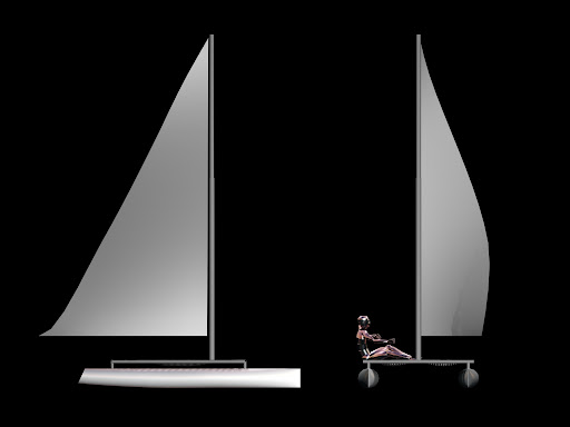

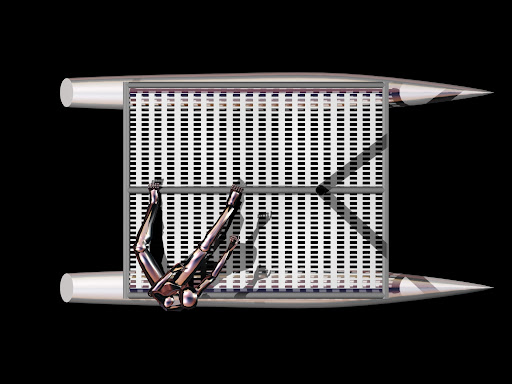

Let's get creative! Cat in less than 200h.
My classes in experimental designing have just begun. We are supposed to do something with a light weight structure. We are encouraged to experiment with unusual materials. We have 96 hours of these classes and after that we have another 80h of other classes in which we can continue the experimental project, if it's a big one. And this will be. I also have a chance to use the workshops at school a few hours here and there, so I'll have about 200h of time to build this thing. My plan is to make a catamaran (or a model of one, if I can't make the whole thing).
The spesifications for the cat (in order of importance):
Very quick to build
Cheap (I'm a student and broke)
Crew of one.
Carrying capacity about 200kg
Lenght 4m (the maximum lenght I can store and move around)
I'd like it to be fast, but with all the limitations, it's not a priority.
Hull is the biggest problem at the moment. It doesn't have to be hydrodynamically optimal. I will not laminate the hulls. It's too expensive, too slow process and not at all experimental. Now I have three ideas on how to make the hulls and I would very much like some comments on these:
1. Aluminium v-hull. Two 4 meters long aluminium plates, weld both of the short edges and one long edge, formed to a v-shape in the middle. This will not be that cheap and the wet surface is very big. Will also need some structure inside to keep it in shape. The structure is very likely difficult (=slow) to make.
2. Get/make a metal cylinder and form it into a hull by flattening the front end vertically to make it pierce through waves and cut the bottom open from the rear and make it overlap a little to make it smaller. This is visualized in the attached pictures.
3. Make a mesh out of metal and cover it with pvc. I have access to pvc cloth that has been used as an advertising on a wall or by the roads. I have doubts about the durability of the mesh if it's light enough.
In case you don't see the pictures, you can find them in here: http://picasaweb.google.fi/Luovahulluus/Catamaran#
