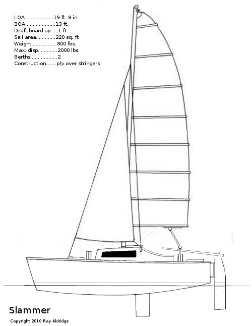

Hey Dan--
Yes, bolts can be a pain, but my new boat will use them. The idea only requires 4 bolts in all, so I think that can be done in just a couple of minutes with a ratchet.
Many of the compromises I've chosen have to do with the goal of allowing the boat to be folded with the rig in place, to allow the use of narrow slips and dry sailing. That's also why the kind of folder that tucks the hulls up under the center deck is not an option for me, because the hulls have cabins, and I don't want to have to unload the hulls every time I fold the boat briefly. This is also why I'm going to try out a central board and rudder, because then the boat can be motored while folded, and with only a central ruder, the tiller bar does not have to be removed for folding, because no tiller bar is necessary.
Ray, your profile view is great. Did you develop some new software skills? Is your immersed forefoot going to lead so some bow steer downwind?
Dan

Quote:
Dan
I'm trying to do better work. In the past, most of this stuff was drawn by hand and then loaded into GIMP for cleanup. I'm just doing more of the work on-screen.
I don't think so. The hulls are just scaled up versions of Slider's hulls. Slider is the best-behaved boat I've ever sailed, so I hope those qualities will translate.
