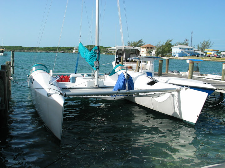

Can you identify this cat?
This is the cat that made me sell my monohull. I sailed it for an hour or two in Elizabeth harbor, Bahamas with a guy who was delivering it to Turks and Caicos. I can't remember what make he said it was and I want one!
This thing was so fast and nimble, we didn't get the GPS out but we had one hull starting to lift a little and it seemed like we were going at least 20 knots; is that possible?
Sorry if I sound ignorant but it was the only time I have sailed on a cat so I have no idea. After sailing this thing, 6 knots in my old 35' monohull seemed like such a drag that there is no way I could ever cruise on another one.
I realise this cat is not a cruiser but my needs are very basic and I have no need for a living room on top of the hulls
This is what I know about the boat. It was 34' long, had one outboard in the center abaft of the mast which was of the rotating type. It had tillers and the rudders were mounted behind and not underneath. It had kevlar sails (if I remember right). It had standing head-room in the taller part of the hulls.
Also how strong is the aluminum pole set-up to connect the hulls? Could a cat built like this endure ocean crossings? It seems a bit flimsy.
Thanks for any help/advice.

Here the picture
I am posting the picture again as it seems to have disappeared from the first post

Great barrier express? I know of a few of these that have crossed between the pacific islands and New Zealand and I'm pretty sure they have crossed the Tasman too.
If you like this style of boat investigate the New Zealand Formula 8.5 class, there are lots of designs to choose from.

Your experience is common for a first time sail in a multihull in a good wind. Yes, it's possible you could have hit 20 knots, depending on the conditions, etc.
I'm not a cat expert, and I don't recognize the make from that one photo. Appearances can be deceiving with regard to strength in multihulls, as weight saving is always a factor in design. That forward hull brace looks light, but there could be some strong reinforcement in the hull attachment points. The bridge deck looks pretty solid.
Overall, she looks fast and might be good for coastal and shorter offshore passages. You'll need an expert's opinion on suitability for long ocean passaging. One of the experienced multihull sailors or designers here may recognize her.

Try Firefly 8.50
Or check out Firefly 8.5, designed by Mark Pescott and built in Phuket (and other places). FUN!!

At over 30ft the cat is a Turissimo. Malcolm Tennant designed a 9 metre and a 10 metre version. The 9 metre one was more popular - quite a few in NZ.
As to your question of tris bouncing at anchor - if you are serious about cruising I would recommend you steer clear of ones with the amas lightly loaded - especially with one ama out of the water at rest. In my years of cruising aboard my Twiggy (31ft racing tri -one ama 2 feet out of the water) we often got a rough nights sleep when no one in a cat knew there was a chop. The thing would flop in a chaotic way. I loved her anyway but I get a much better sleep in a cat.
Another thing to note - these racers that feel so evocative will not be the same when you put all your junk on board. A multi with slightly more volume in the hulls is needed - it is all about the immersion rate. Look at multis cruising - heaps of them have sterns immersed or have had transom extensions. As opposed to your mono the things go down really quickly with any weight put in them.
