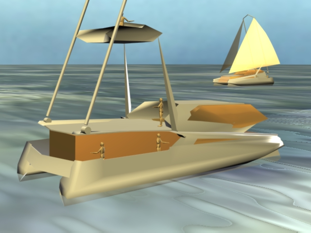

So now that I’ve turned you on to two really good articles, I’m going to digress a bit.
In the article “Shootout” Bruce reinforces the general need to innovate, and innovation in tower design in particular, by referring back to a pod tower concept designed by the Fla fisherman and builder Jim Smith back early in his career 1959.
Here is that ‘pod tower’ concept as included in the ProBoat article:
An Innovative Tower
The accompanying photo of Boca Jima—a 35’ sportfisherman designed and built by the late Stuart, Florida, builder and fisherman Jim Smith early in his career—ran in the May/June 1987 issue of WoodenBoat magazine. The boat itself was built in 1959, cold-molded of double-diagonal cedar and epoxy, and capable of 44 knots, a speed still impressive today. But it was the innovative aerodynamic styling and functionality of the pod tower concept that remains especially appealing to me. Strangely, Smith’s good idea, which also replaced the conventional port and starboard tower access ladders with an elevator, was not embraced and copied. This tower—a radical departure from existing boats, then and now, might have been a bit too extreme for the sportfishing fraternity.
According to John Vance, president of Jim Smith Boats, there’s more to the Boca Jima story. “Jim was a real innovator,” he said, “and sometimes looked to Detroit for styling trends. Boca Jima has a hit of a ‘57 Chevy look to it, doesn’t it?”
“Look closely at the picture. Note that the contours of the tower’s hardtop match the contours of the top of its pod. There’s a crank mechanism that retracts the top so that it sits flush on top of the pod, which reduces drag and protects the pod from the weather. Jim chartered the boat for quite a while. He had a wooden leg from a motorcycle accident; the elevator was a big help to him. But he told me he’d leave the car in the up position so his charterers wouldn’t pester him.”
“Jim was an early adopter of many things.” Vance continued, “including adhesive bonding. Boca Jim’s tower was braced by four aluminum sailboat masts, with flanges welded at their bases. Jim bonded the flanges to the deck and cabintop with whatever the equivalent of (3M) 52OO was in those days, using just a few screws to hold each flange in place. Everyone thought he was nuts. When the boat sold, the new owners tried to remove the tower so that it could be bolted down more conventionally. They tore off plywood trying.”
Kind of radical, huh? (to be cont…)

So upon seeing Jim Smith’s radical tower and a few other items in Bruce Pfund’s article ‘Shootout’, I just couldn’t resist the temptation to write a ‘letter to the editor’. I tried to write it with a little ‘tongue-in-cheek’ humor as I really respect Bruce’s work.
I was quite surprised when I found out the letter was published in the most recent issue PBB No 103, Oct/Nov
________________________________________________
Ltr to the Editor of Professional BoatBuilder
Just looked thru Bruce Pfund’s latest article “Shootout” in PBB No 101, Jun/Jul ‘06. I thought I would drop you a short note to be taken with a little light-hearted ribbing.
I’ve really enjoyed Bruce’s articles in the past, and particularly took note of one where he detailed the fishing cockpit, PBB No 78 (“Sportfishing Boat Layout”). I hope to make use of some of those insightful details when I finally find a brave client to really push the boundaries of a new gamefisher design: http://www.yachtforums.com/forums/general-yachting-discussion/1548-gamefishing-sail-under-sail-power.html
In “Shootout” Bruce wrote, “…deviations from the day’s norm are small. Will anyone dare to break away from the now traditional tuna tower and try a single, aerodynamically efficient, unstayed mast with an aero-style crow’s nest…” Well I guess you might say I’ve taken that 'crow’s nest-on-a-composite-mast’ challenge to the EXTREME. I’ve extended that mast, and added a sailing rig. I need to expand the size of my crow’s nest a bit more, and it wouldn’t necessarily have to be located as far up the mast. I do like the idea of the ‘elevator’ as on Jim Smith’s Boca Jima. He was quite an innovator wasn’t he.
Interesting that Smith did not feel the need for the additional flybridge helm as well. I had included this additional helm on my deckhouse roof since the crow’s nest was not sufficiently expansive in my original drawings. I had also considered exploring a sort of fold-away, pop-up, podium type helm station at that roof location. This would provide for good communication between the captain and the fishing cockpit in close fighting situations, and might be rigged to handle the teaser reels also.
Bruce wrote, “Will 2006 be the year that large low-drag unstayed carbon outriggers appear?” I think being able to clip lines on both my twin backstays and my relatively short unstayed carbon outriggers, and across the whole big beam of this vessel, should make for quite a bait spread without unruly longer riggers.
The new Volvo IPS prop system might substitute for my belt-driven concept, but lets go up another whole notch and eliminate conventional props and supports altogether. How about adapting the latest Rim-Driven Propeller technologies:
http://www.yachtforums.com/forums/23867-post8.html
http://www.yachtforums.com/forums/technical-discussion/3961-rim-driven-propellers.html
These propulsion units can be 1) smaller in diameter than their prop counterparts, 2) tucked under the hull closer to the hull bottom, 3) located further forward from the transom, 4) retractable, 5) far less nosey, 6) less susceptible to fouling, 7) serviceable without hauling the vessel, etc. Rim-drives are electrically driven by a magnet component in the rim of the prop, so they would require the latest technologies associated with diesel/electric propulsion. Carbon blades in the rim-drives combined with low speed, hi-torque electric drive would produce phenomenal maneuverability at slow fighting speeds, and without any reduction/direction gearboxes.
Plus you would have all of the electricity you could possible want onboard without the extra weight of the usual one or two auxiliary generator units. Set up right this could be a real fuel-sipping offshore fishing machine (much less fuel weight to propel & haul around). The sails could all be electrically furled.
Bruce mentioned, “within a year or two the first oven-baked, carbon-fiber, pre-preg sportfisherman will arrive on the scene….the quantum leap its presence will represent…” By analogy this 65 gamefishing cat I’m proposing done in all-carbon might find its nearest comparison with the very lt-weight built GunBoat 62 catamaran:
http://www.deltayachtsbrokerage.com/dyeng/gunboat-en.html
http://www.gunboat.info/home.html
My design will of course be heavier with its significantly greater engine power, and it won’t carry that same sail area to displacement ratio, but it does maintain that slenderness in the hulls and could be a relatively lt-weight carbon build.
Upon looking at the opening photo of the article down the long line of boats, I noticed that not one of the vessels had a tender onboard (nor chocks for same). These vessels are all ‘dock dwellers’. They would have a hard time spending a night away from the dock, or a few days away from a fuel supply. So rather than refer to them as ‘offshore fishing vessels’, I think they might better be termed ‘tournament fishing vessels’. They are specialized for tournaments, something mine is not.
I am also developing a specialized RIB tender that can be carried up front, (two in my case), without concern for its being swamped by a big wave over the bow. Tenders become akin to one’s car when you get away from the docks and/or into remote fishing locations.
Bruce wrote, “The challenge is to innovate while still creating a boat that is not so radically custom, or weird that no one will want to buy it. Or that is so finely tuned for a particular fishery that its efficiency is compromised when chasing other species.” Well I guess I failed the ‘radically custom’ part by a long shot, and it certainly hasn’t been easy coming up with a client to buy one (the mixture of sail with fishing or power has been no easy sell). But then I have never represented this design as a tournament boat. It is clearly a ‘get out there on your own bottom, go-anywhere-in-the-world’ vessel. I would surely think there’d be a few of those really adventurous fishing guys around. My vessel should not appear so radical to them, and its versatile enough to fish on the flats as well as the ocean.
And it just might fair well in a couple of tournaments…..if they dare let her in.

http://www.boatdesign.net/forums/att...4&d=1164842448
at yachtforums i reply'd to that fishing tower
Quote:
hi guy's, first say "yek" three times before even thinking of putting sails on a fishing tower
now think about it, if that tower is a easy to fold down around the housing bi-pod mast
of a motor sailer and look eastectically attractive it would make sence, would it not?
as say'd, first "yek" than think before shooting the piano player of this variation on a theme
http://www.yachtforums.com/forums/at...g?d=1162157053
this lifting tub anex crows nest is all too rough and studying a-symetric cathulls, rig planning a better drawing, but yeah sure agree on
Reply With Quote

we have about an inch board bonded in the deckmold, very good but once almost broke my legs anyway
on the "dangerous" stuff, here some fishingtowers as i think of them, saw YAW's yesterday again with another fine sample
on my ladybird design the mastheads should close but the wings should stay lower and a cord apart
i now imagin a winglet nest there in the top (and a carterpillar drive on the bottom)
in another thread it was mentioned a crows nest or tower on a cat is more jerky,
thats a minus but logical and again depends on hullshapes
