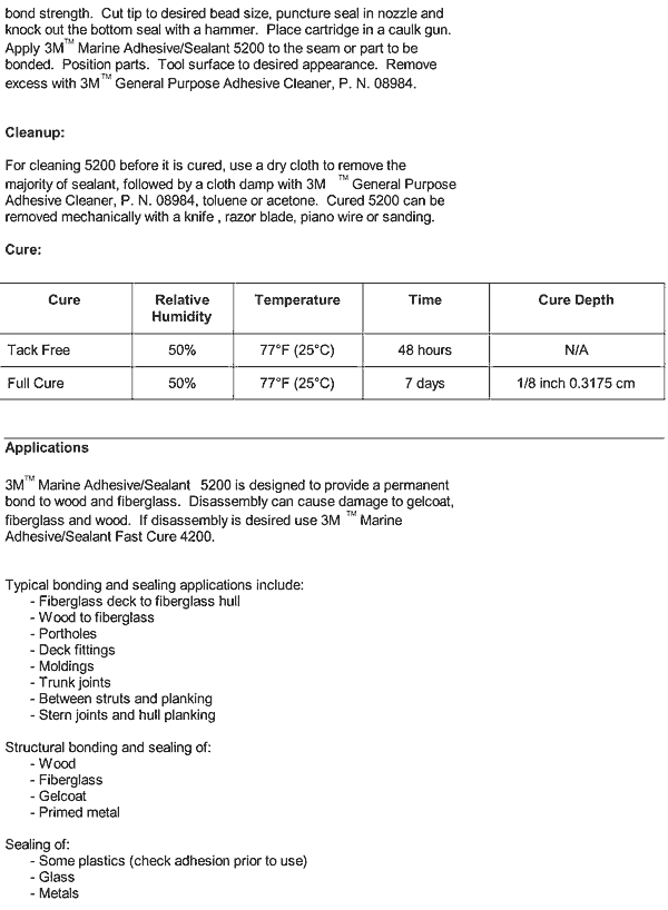

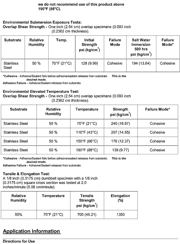

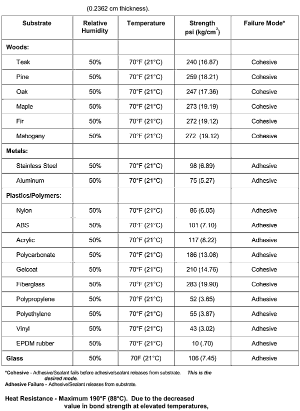

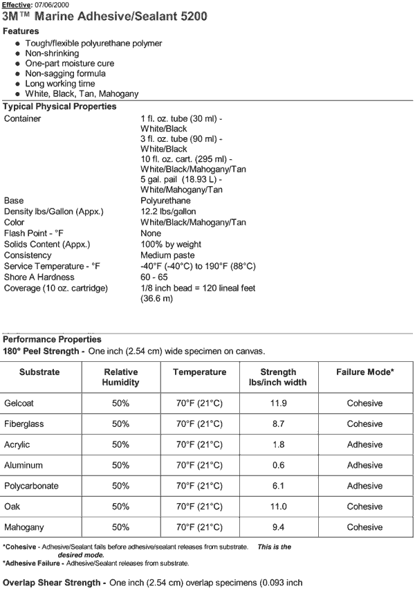

All I have is the stock peel and shear strength tables from a scanned 3M data sheet but you probably already have that...

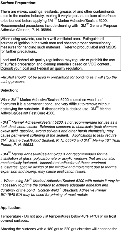

Should the bond be bare metal to GRP or is a painted surface adequate?

A bond to a painted surface is only as good as the bond betweent the paint and the substrate.
