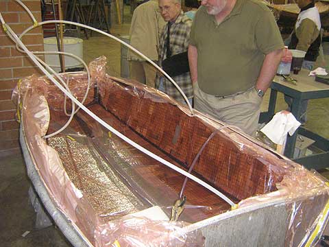

To install the vacuum line you need a "resin brake". This is something that air can pass though and resin can't. Magical stuff.
Lucky for you, peel ply makes a wonderful resin brake. Resin can pass through peel ply from side to side easly, but it has a really tough time flowing along it.
Here's a mini example of a boat we infused just this last week.
Now, we used the spray adhesive to hold everything together including core etc.
Along the bottom you can the resin feed line. Its peel ply and some flow material to get the stuff out to the ends in a hurry.
Along the top edges are the resin brakes hooked to the vent lines.
To make a vent line; Take a 1 foot wide strip of peel ply and, using the spray adhesive, fold it over a spiral cut tube with a "T" in the middle. Then glue this to the edge of your laminate stack. 1" overlap is good.
The folded part with the pipe in it should be hanging about 5" from your laminate. This gives 5" of time and keeps the heat of the resin in the pipe from overheating your part when it kickes.
Oh also, you can't use woven roving for infusion, it doesn't flow. This stuff in the pix is a biaxial glass that's designed to flow. The core was also designed to flow and it speeds things up a lot.
This hull was infused in 9 minutes. It was the first attempt for this mold. An experement 'cause this mold was never designed to be used as an infusion mold. (Seem's to have worked though)
A couple things : Make sure you can hold a vacuum on your mold BEFORE you start loading stuff in there.
You will also need a vacuum leak sniffer for finding those impossible to find leaks.
Good luck, don't spare the monkey poop, I hope this helps.
-jim lee

Typically you -do- put the resin brake on the flange, that is a good spot for it. On my picture we didn't have a flange so we hung them kinda' out in the air. That was a pain! If you can get a flange, do it! They say 6" is what you want for a flange.
We've not tried a 2 part mold, so I can't help.
How to not use too much resin?
#1 Pull a solid 29.9 in Hg vacuum.
#2 make sure your resin bucket/barrel is not higher than the part your infusing. Level is good. Then you should get the correct amount. Higher can flood the part cause it will be under pressure.
To gelcoat or not gelcoat and paint later. Paint or not, I'd -always- gelcoat first. Why?
1 - The gelcoat helps seal up the mold so it does a better job of holding a vacuum.
2 - Gelcoat also makes the part easier to pull out of the mold.
3 - Gelcoat seals the mold so the resin under vacuum won't get into the little cracks in your mold and cause the mold to break & chip when demolding your part. We learned this the hard way and I have a mold to fix now.
Skin coat to help the gelcoat? A skin coat is going to add weight, but it very well could save your gelcoat. It seems like its one or the other. For the lighest machine possible you maybe can let it run with print through? Or respray and sand it smooth? We've not been able to solve this one yet. From what we've seen, the print through is the worst over the core. You can almost see where the core pieces are if you get the light right on the exterior of the hull. (But it is light!)
As for the spray adhesive; We haven't experemented that much with different sprays. Every one says to go sparing with them. One hull here has dry spots and its currently being blamed on too much spray glue.
