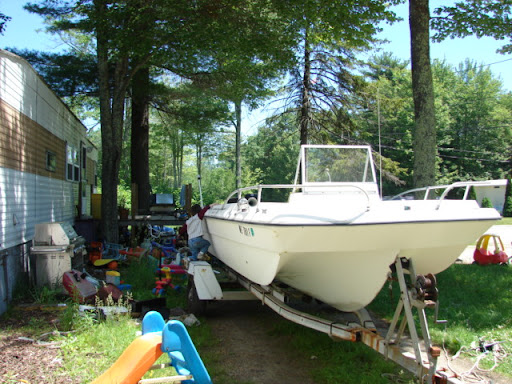

I just bought this center console. I really like the hull design. I get allot of deck space in a small boat.

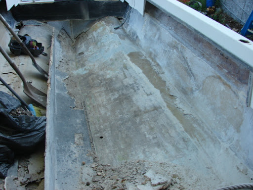

This boat is a 1973 Cruisers Built in Wisconsin. I found that the hull was leaking , found the bow had been crashed and they filled with filler and did not adhere well. I also found the inner core of the hull was rotted out it is made of end grain balsa and it is bad from bow to transom.
I would like to take out the bad balsa and replace it by building up the hull with glass.
Like to know how thick would be enough?It is about a 1/4 thick now.
Then building a stringer and eggcrate type support system to keep hull from flexing filling under the sole with foam to further support the hull.
Do you think this is good idea or bad ? If it will work?
Or do you think i should replace all the balsa core and re skin inside.
Here is a pic of the boat fully dressed.
Here is one with the balsa removed from right side of boat.
I really would like to make this hull usable agian. Any help is appreciated.

When you say inner core of the hull are you talking about the running bottom of the hull or the deck's and gunnels? Any fiberglass baot can be repaired but be prepaired to put a lot of time and money into to doing so. Keep your questions coming and I will try to share what knowledge I have, if you can supply some photo's it would be easier for the board member's to help.

Let me ask a question Mike. On a full fiberglass hull how thick is the the glass. I would like to make this just a fiberglass hull and eggcrated support system with poured in foam between the sole and the hull.
The three questions are
1 how thick does hull need to be.
2 will my plan work
3 can i get away with useing poly resien for the glass build up and epoxy for structure.

Hull thickness can vary but on my Steiger I drilled a hole for washdown 16 inches in from the transom and 12inches up from the keel and the cut out was about 11/16 inch thick, I would say anywhere fron 1/2 to5/8/ inch.As far as whether your plan will work I don't know, stringer placement is critical you want support but at the same time you do not want to create hard spots in the hull and without a referance point to start I could not begin to tell you where to put them. As far as resin stick with epoxy poly I would not even consider and the price of vinylester has gone up so much it does not pay, you would also have a hazardous shipping cost to go with that. Try www.aeromarineproducts.com or fiberglass coatings inc. both are great to deal with and their prices are in the range of vinylester resin. Good luck with your boat.

Thank you Mike. I have the placement of the original stringers marked.
I was going to put the stringers in the original spot with 1/4 inch foam under them . I want to put lateral supports in to stiffen hull simialiar to a wood boat.

If you really want to fix this then.
1. Sand, Grind or cut everything that is between you and the rotten core.
This is easier than it sounds, I use a circular saw and mask
2. Put boat upside down and let it dry - for as long as it takes, It leave for a month in the sun. Sometimes I pour acetone inside hull in some areas. The Acetone dries quickly and drys everything around it quickly. Obviously this is a dangerous procedure - NO Smoking and do it in open area. Let it dry for a couple of days.
3. Choose areas that need reinforcement. Sand then use fiberglass weave mat with Epoxy Resin. Epoxy will bond to Fiberglass better fiberglass to itself. Epoxy runs like water. Paint it with brush on mat but it will flow into every nook and crack. A second application will probably be desired after 4-6 hours. Make sure boat is level and straight when you do this otherwise you might endup with a crooked boat.
4. Then look at what you need to add back for structure, floor etc.. Use wood and regular fiberglass to make it back into a stiff hull. Fiberglass will not grab to epoxy. But for repairs Epoxy is better than polyester resins.
5. This might be a good time to reinforce transom or area around cleats, etc...
You do this and you have better than new boat
Hope this helps.

I have removed all the core material and the encapsulating glass. I have sand the entire hull. I am getting ready to repair the holes in hull and the start reinforcing the entire hull.
I plane on putting two to three layers of 1708 biax. This is going down with epoxy. I will do this to the entire hull then put my stringers back in in the original spot and the built floor hull supports laterially about every two feet except where i paln to put my gas tank. then i will foam fill all the hull cavitys under sole leveling out the foam to the bottom of the sole. The sole will be sealed to the sides . I will have only an access panel for the fuel tank.

If you want to create a stronger laminate use alternate layers 1708D.B.45 degree and 1808 D.B. 90 degree.( All this means is the angle at which the strands cross.) Good plan this should beef up the hull pretty good. I would go with 1 1/2 ounce stitch mat laid down first to make sure I get a good bond to the hull,Then a layer of 1808 then 1708 and a final layer of 1808 this should give about an additional 5/32s of an inch thickness. I order all my fabric from U.S. Composites, they cary all the speacialty fabric that your looking to use. My epoxy comes from www.aeromarineproducts.com, six gallon pail delivered to your door for about 300 bucks. Good luck with your boat.
