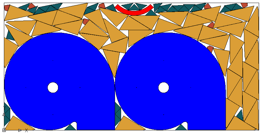

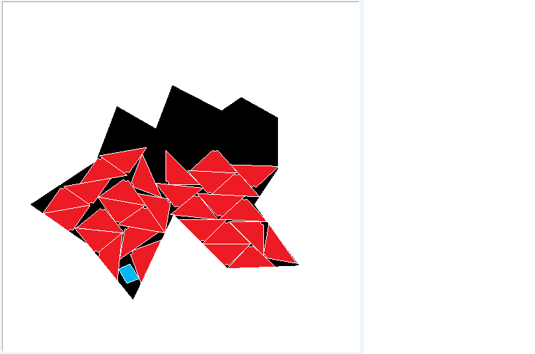

In order have a more good material utilization for complex parts, we developed a new nesting algorithm. It would be a really true shape nesting tool and can meet higher requirement. It can nest on any shape of material (import material from DXF/DWG file) even there are holes in it. It would be a good assist tool for many applications like wood, cloth, sheet metal, glass, leather, etc. You can use the nesting result for laser, plasma, waterjet and other cutting or router machine.
In the final stage before release, we are looking for Beta customers who are interested in nesting software and like to try new tool in their work. All Beta customers would receive a license file without any limitation (full function and permanent). We hope to hear more first-hand suggestions and feedback for you.
Please send us email support at nestprofessor dot com with note of your business application and machines.
