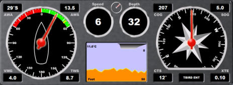

    NMEA Display
    Aviadesign.com has a free tool to display which NMEA sentences are available on your network.
    Avia Sailing software provides a complete set of sailing instruments inexpensively. It can be used with Tack-Tick or any other instruments which output NMEA 0183.
