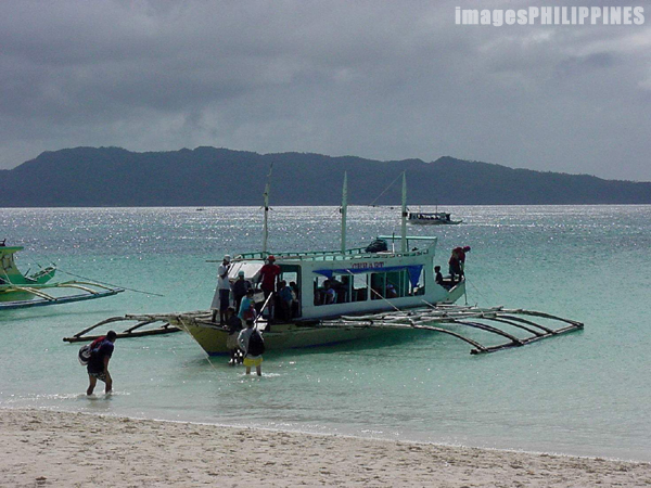

The economy of operation of a wave piercer would make it an ideal long distance cruiser on the ICW. It also has good load carrying capability.
I'm thinking the same thing. I am hoping to take a trip on the ICW and do the Great Loop in a few years, in my own boat that I have built in my my little shop in the Philippines, and I'm interested in these boats because of their cruising economy ... and their spaciousness.
Boats like these might actually serve as decent ferries for shuttling people in between islands in the Philippines, although the typical Philippine 'banca ferry' seems to be relatively efficient at this task already. Here's a picture of one that appears to be enclosed, or perhaps only semi-enclosed:
But bancas are not "high-tech" enough for the rest of the world, whereas the super-efficient catamarans used by Dohm's Water Taxi just might be.
