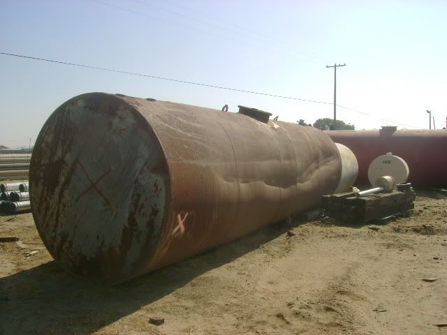

yeah, i read all those, that's why i'm asking these questions. I didn't see the *thick* metal hull (3/16 or more) over or under concrete addressed- more of rebar and wiring/fiber in mix etc. My idea was almost like a two hull of different materials question. And, if anyone had experience or know about pressure and stress on poly joins and how difficult they are...i'm in the process of just looking at all of these things. So any ideas are welcome. I really am thinking about reinforced metal tank designs though.

like with something like this.

that was an example of the shape, mind you...
