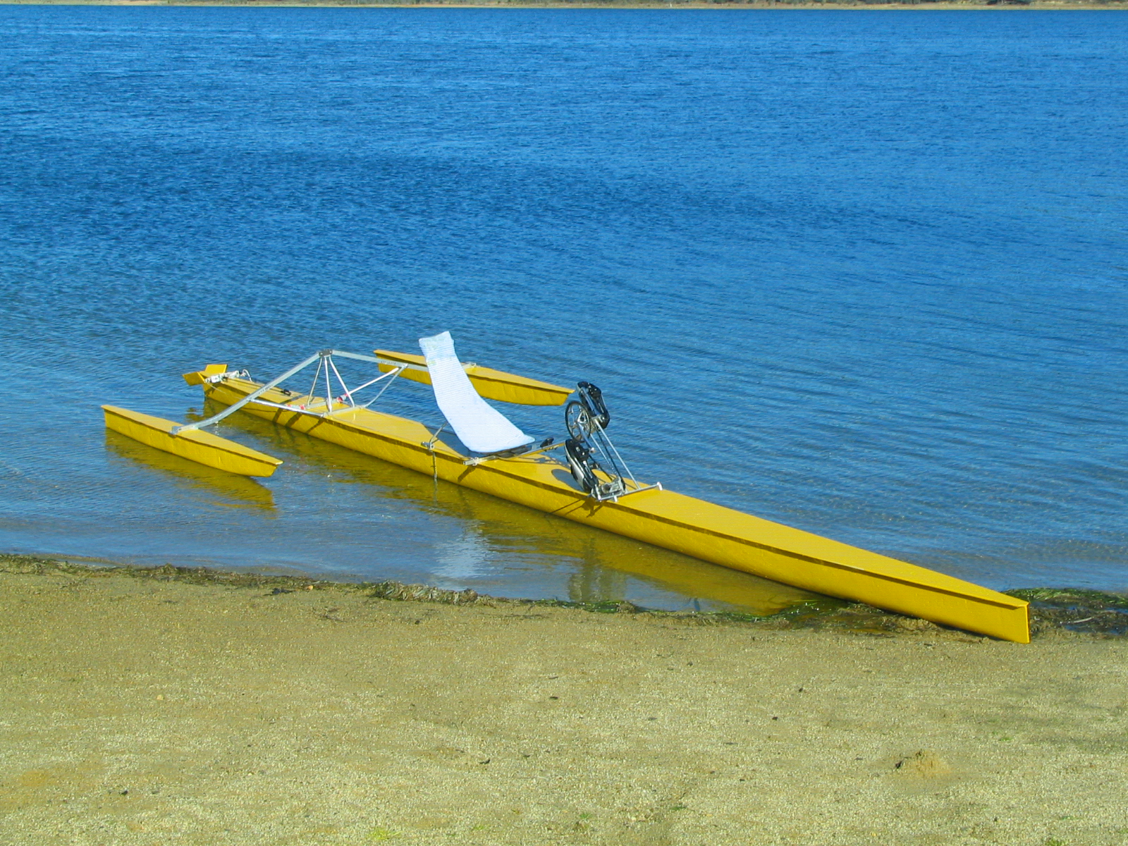

One thing that keeps coming back to mind, is a Hybrid type
people powered boat, as in:
Pedals turn a flywheel, flywheel turns a small high efficiency
alternator connected to small battery, as, lawn mower type.
Long slender hull, out riggers, you seem to have the best
in hull design as it is. Electric motor in streamline nacelle
as, a long slender skeg.
Simple drive, weight?, Pedal a while, rest, pedal a while rest.
When you get tired, just drive it back to shore! Drink beer!
I saw something where they used a small tire filled with
antifreeze as a self balancing flywheel.

All those things just add weight, complexity and inefficiency; not to mention cost.
If I get tired I just slow down or stop. Below 8kph the required effort is less than that required to walk.
The only appendage drag I have on the current boat is a 1/4" diameter shaft that is mostly aligned with the flow and a 14mm diameter bearing housing hanging off a 1.6mm thick strut. Anything bigger is added drag.
http://boatdesign.net/forums/attachm...0&d=1218255936
A flywheel improves the feel of the pedals but the gain in pedalling efficiency does not offset the added weight and losses involved in mechanical energy transfer.
Batteries are the most effective means of energy storage but losses involved in generating and motoring offset any gain other than for a burst of speed.
Rick W

Photo linked in earlier post is optimised for long range cruising. The hull design was originally developed for a 404km race that I did a couple of times.
The design condition is 12kph at 150W. Once you encumber the boat with the weight and complexity of a flywheel system the speed will drop off considerably.
A copy of this boat is being prepared for a 24 hour world distance record attempt in North America right now:
http://www.adventuresofgreg.com/HPB/HPBmain.html
So it is a long distance cruiser for relatively sheltered water.
A boat for max speed would have foils and I would make it as light as possible.
Rick W
