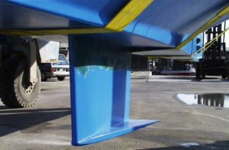

Here ya go. I saw this listed for $375,000.00. You could not build it for that.
