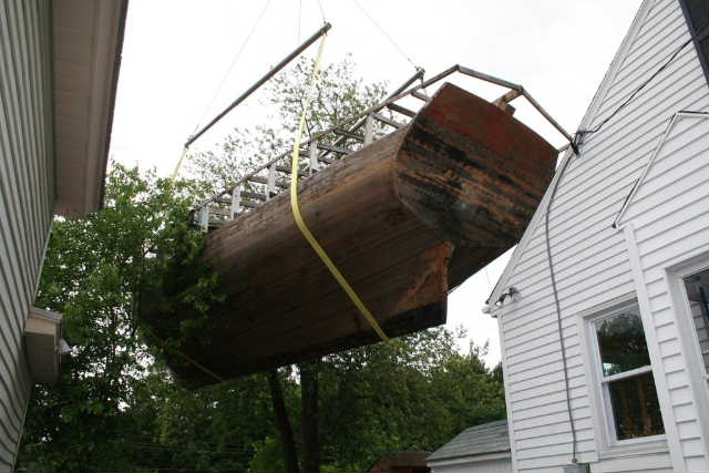

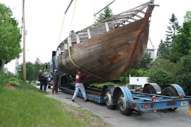

there is a guy called Bluemarble (Matt) on this forum
who bought a half done 40' wooden spray
the story started on this thread
http://boatdesign.net/forums/showthread.php?t=10274
where someone else was asking if they could saw the thing in half to get it out from behind the house it was built rather than pay for a crane and extra transport costs...
he didn't end up buying it
but someone else did (Bluemarble and his girlfreind)
heres his thread
http://boatdesign.net/forums/showthread.php?t=13015
they lifted it over with a crane
two photos here
http://matt-barker.com/boat/boat_moving/ (lotsof photos here)
Big job but a much bigger boat.
Good luck,
