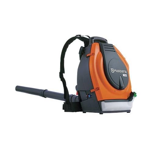

What would that be in CFM?
Conversion:
http://www.madsci.org/posts/archives...7528.Ph.r.html
I'm thinking you could use a large leaf blower.................maybe not.
link:
http://www.amazon.com/Husqvarna-Back.../dp/B0008FXOZ0
Quote:
Technical Details
* Engine: 44cc 3 HP
* Air Velocity MPH: 177
* Air Volume CFM: 473.2
* Additional Features: Lower noise and emissions, Tube-Mounted throttle control, Padded harness and load reducing hip pad
* Weight: 23 lbs.
It's lots of work building your own duct and getting the tolerances just right.
I've looked into HVAC fans, some set up with electric motors. These are heavy and don't generat lots of thrust because when used in buildings they need to be quiet and not blow people around. Super duty fans used to bring fresh air down into mines are heavy and not designed to be mobile at all.
I've been looking for a pre-made fan and duct set-up which could absorb a typical automobile engine's power, lets say 200-300 hp. I've had no luck. Smitty airplane/hairplane company looked like they were going to bring something on to the market for ducted jet-like kit planes, but they have not followed through. I think they were just fishing for investors at Oshkosh a few years ago.
