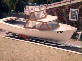

I was thinking more of me making the timber inner liner console plugs for the manufacturer to use to make the glass liner and console.
I doubt after one attempt at glassing I could take on an inner liner 25ft long! I reckon I could do a fair job of a console tho, it's a "bite sized project" I reckon I could do (having already made one timber console and gear locker for my little 16ft river boat!)
Timber works not a problem for me - I can take a log from the forest floor and end up with furniture on the showroom floor. timberwork doesn't scare me.....I had 8 years as a forester and now own a sawmilling / kiln drying / furniture making shop...so "makin stuff outta timber" isn't worry.
It's the glassing has me scared.
My ol dads 71 now but he was quite a timber boat builder in his day and has taught me the timber joinery furniture game over most a my life I guess at one time or another.
This was an 18ft Randall design he built when i was just a kid in our back shed...
It's a bondwood, with a glass skin, inboard.
I've kinda grown up around boats and timber work...
It's not like I've got a shortage of timber suited to boat building, and it only takes 3 or 4 months to produce another kiln full if I ran out - in truth I probably should start timber boat building - but I KNOW how hard they are to maintain and how they deteriorate rot and also how laorious they are to build with scribing and hand fitting each piece several times to get an acceptable fit.
These days to my mind it makes more sense to do a CNC plasma cut alloy vessel construction package professionally designed and welded just for time savings and maintenance reasons.
Having built the 16 ft myself this way - I can't see the point using wood, except for some fancy polished trim maybe inside a cabin or berths or for say a nice feature console or something!.
Check out this boat - she was a lovelly ol gal...18ft tumblehome ...
Len Randall was a great naval architect hereabouts in my dads day...many many of his boats still plying our coast.
Cheers!
