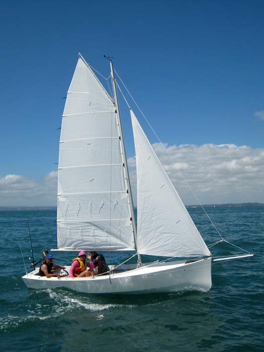

    Do you have any examples of the types of boats you mentioned in the 17'-22' range? I was looking at boats with flat sides, no curved hulls. With a main and jib and a boat that can be sailed fast, not necessarily raced, in the ocean.
    Regards,
    Nick Dunning
