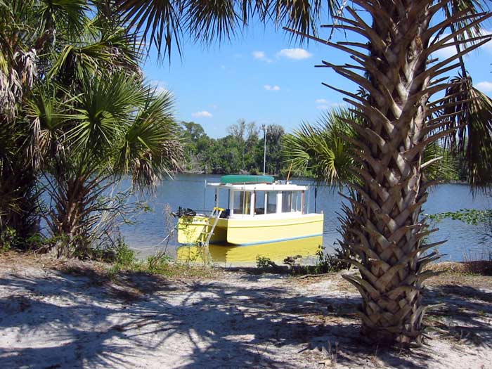

What health concerns are you referring to? Mobility issues or something else?
If you really don't need or want the deeper draft of typical high-speed sailing catamaran hulls, I might suggest wider hulls for shallower depth and easier beaching. Or maybe you'd like to consider something like an enlarged Bolger Bantam. Here's a couple links to some duckworks articles with images to follow:
http://www.duckworksmagazine.com/07/...ntam/index.htm
http://www.duckworksmagazine.com/08/...rida/index.htm
Obviously the Bantam is a much smaller boat than you're looking for. I'm posting the pictures to give you an idea of the concept, that's all. A larger boat build in a similar style might be a really comfortable live-aboard. The trimaran concept seems to work well here.

The good thing about Bantam in terms of mobility is that the living space is all on the same level -- above the hulls -- which makes life a lot easier. A boat like an enlarged Bantam would actually be ideal for a wheelchair-bound person and his/her companion. Keep in mind that this is exclusively a power cruiser and not a sailboat.
I would not suggest a direct scale-up of Bantam, but if you like the 'concept' a similar but enlarged custom boat would be relatively easy to design. I've sent you a 'private message' via this forum with some information you may find interesting, so please check your private messages when you have a chance.
Getitng back to the boat's design, I tend to design for the actual use of a boat first, then worry about aesthetics later. The fact that you've already said these things:

... makes me think a boat similar to an enlarged Bantam might be the best type suited to your particular cruising style. On the other hand, you also said this:
Quote:
Sails, probably junk rig.
... and Bantan is not a sailboat, it is exclusively a power boat.
A similar but enlarged version could be designed as a sailboat of course, but do you really want to deal with both sails and engine power? On canals and narrow waterways, and when there's not enough wind (or too much wind) you'll be using the engine all the time anyways, so I wonder if the extra expense to design and build in sail power is really worth the effort?
It might be worth the added expense if you plan to do most of your cruising in big bodies of water where the mast won't get stuck in trees for example, or where you have enough space to tack back and forth when trying to get upwind. But unless I'm mistaken, the description of your cruising grounds would make sailing possible only for a very small portion of the time you're actually on the water, and this is why I wonder if you would really need the sails at all?
