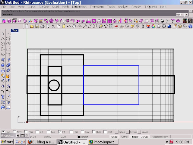

    Drafting board and paper is the way to go. I have spent all this time getting software to work only to realize I should have just drew the grid out on a wall and started building something, honestly.
    Looking at the first photo mock-up, you are right concerning it needing more aft support. Needs to extend back one more notch like this..
    This type of proportional spacing is much stronger and can be built lighter than by evenly spacing cross members on even patterns. It' just plain old math/physics. No magic. No more magic than gravity.

    I would hope that we wouldn't have any problems like hogging with a craft this small and with the amount of internal framework we have designed. I did find a scanner to copy the drawings so maybe tomorrow i might have something to post..

    here are some prints but they are pretty light and hard to see.

    One drawing is the side view, another is the top view showing the frame layout, another is how the bulkheads will be cut
