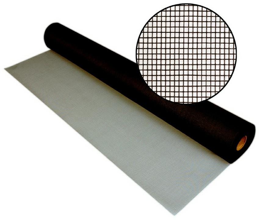

I've made small 1 and 2 ft square molds of plaster and sealed them with cheap spray paint in a can. A coat or two of wax and some pva and they work good. They can capture an incredible amount of detail.
Fiberglass window screen works good for reinforcement. For that matter, I've heard of window screen being used instead of glass in layups. I suppose metal window screen would add an interesting sort of strength to a "fiberglass" layup. Anyone ever tried it?

What please is window screen Fiberglass???
Do´nt let me die dumb please.

window screen is a wire mesh to keep bugs out
and the post was to add it to the fiberglass or instead of fiberglass
i dont see the advantage unless fiberglass irritates you

Wardd, I know what that is. But Sam said "Fiberglass window screen" and I have no clue!

It's hard to find metal window screen in lots of places. Up here, what you find is made out of a plastic they call fiberglass.

I've never used it but if resin stuck to it it might offer some structural goodies like light weight, flexible, stretchable, who knows what else. Sort of cheap also.
Quote:
Fiberglass Window Screen 96"x100' Full Roll 2.4 x 30.4 meters
$129.95
Standard fiberglass insect screen used on most windows and doors. Available in charcoal color. Easy to install in window screens. Mesh is 18x16, .011 diameter.

Richard, you can get aluminum, steel, painted steel, galvanized steel and stainless steel (really hard to find), bug screen in this country. The 'glass materials are easily the most common now, but only in the last few decades. The metals are still used in tougher environments, like animal enclosures. Elongation issues would cause problems if used in a resin matrix for most marine applications. The coated screens would have peel strength issues as would the aluminum, unless etched just as you applied the resin.
