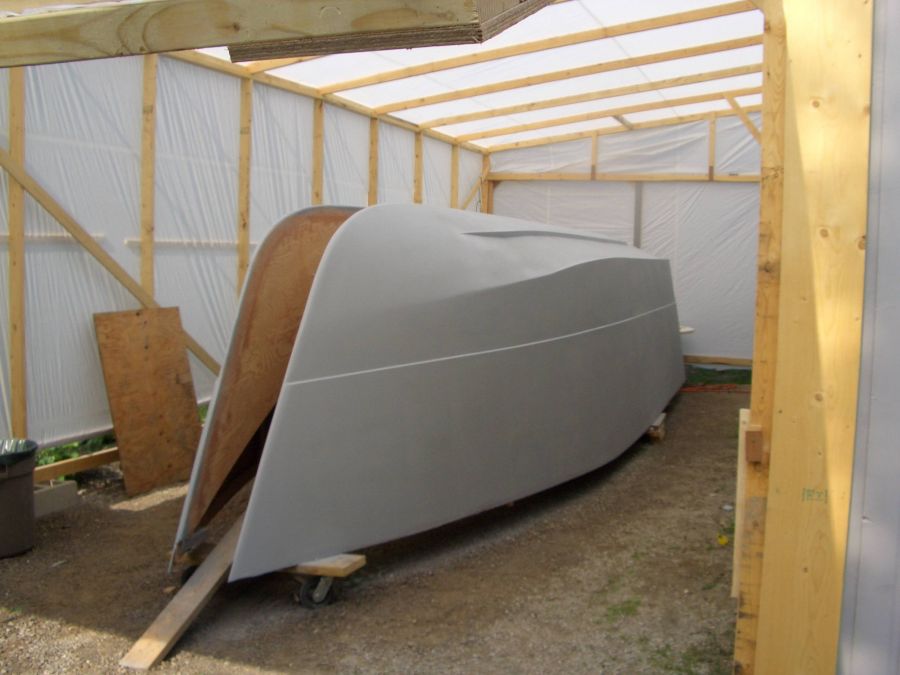

Interesting thread. I looked into a lot of different boat building methods, they all had some disadvantages. Stitch methods leave all those little holes with bits of copper wire, and then there’s all the sanding of the epoxy fillets. The finished boat shape magnifies any errors in the lofted plank developments and cutting, and the individual planks are flimsy.
Framed methods increase the weight compared to monocoque construction. I love the look of glued lapstrake and strip-planked boats but I resent the material cost and effort that goes into any kind of mold that doesn’t form part of the finished product. As my boats are slowly getting bigger (there must be a medical name for that) the handling problems of rollovers are becoming more apparent.
For some years I have worked with prefab flat panels - similar to Boat Fan. I found it was ideally suited to smaller boats, and I am looking into how to adapt it for the larger craft that my medical condition requires me to build. Presently I glue chine logs and inwales to the sheer planks while flat, makes ‘em tougher and easier to handle. Flat bottomed boats are very quick with this method. For five-plank construction I also add chine logs to the bottom plank, attach it to the stem(s) and a mold or two, then plane the edges to fit the bilge planks, which are simply cut to fit. Errors in developments are not very important, very little waste, and I can use cheaper glue for all the joints except the last ones, for bilge planks, which are the only ones exposed to water.
Adding internal construction seems a bit of a hassle. Getting a good fit inside an existing body is more difficult, access can be a problem, and I find fitting a bent panel between bulkheads with really tight joints all round can be a real challenge. More skill needed here than building the basic hull.
Therefore I am working on adapting the prefab method to a larger boat with interior construction such as a cockpit. Briefly, I am thinking of building the cockpit and buoyancy tanks first, using those as a mold around which to bend the hull planks.. It seems to eliminate many of the difficulties and objections I have with other methods. I am also looking at rounded bilges instead of hard chine; these will be cross-planked in a lightweight lumber. No doubt it will be a learning experience just like all the other boats were ...
I must just add this: having a live and accessible designer is a huge advantage especially if you are using a different or unusual construction method.

  #26
Old 09-24-2009, 04:52 AM
boat fan's Avatar
boat fan boat fan is offline
Senior Member
Join Date: Sep 2008
Rep: 357 Posts: 679
Reply With Quote

Ok just to answer a couple of questions
The wire holes left behind of SNG on my little chigger drove me nuts, way too much work and even though i had the panels CNC cut, i hated the "wobbly" construction of SNG. I tried different types of wire - all lousy IMHO. Difficult to get in between the wires to fillet, so you end up doing fillets in stages. You cant go near the boat with wet fillets, so you wait. Extra work - extra frustration, lost of sanding. I experimented LOTS on the chigger with holes, wire, layups, sanding methods, sanding machines, epoxys, and everything else. One thing that worked well from day one was "bedding" the furniture and stiffners down onto the skin, this worked very well. No gaps, where water can creep in and rot. Easy to fillet and sand. A clean job.
With the Jarcat hulls AND the basket frame i was in heaven. Just the minimum of screws thru the panels into the frames to hold it in position firmly, and no where near where i was going to fillet. All panels cut by hand jig saw. CNC cutting is very expensive and after riding back and forth and explaining to the CNC folks what i wanted, i realised that i might as well loft and cut myself - IT WORKS. Bedding stiffners and furniture once again easy.
But i was still not happy with my fillets - too much work - NEW EXPERIMENT
Manie's Shiny Dinghy
here i realised that filleting is part ART part SCIENCE part experience
make your own tools - filleting is like welding PRACTICE
i now lay a fillet down ONE SHOT - - NO SANDING !!!
mix paste and put in plastic bag
small hole - squeze out like toothpaste carefully, like "welding" into corners
scrape smooth with "putty" knife
wait 2 hours to "tacky"
paint light coat of epoxy - roll out fibre cloth - saturate, work in lightly with paint brush - roll on peelply
next morning JOB DONE - EASY PEASY
light quick sand to clean up only
that is why i built the Portuguese Dinghy, to prove to myself that i can do it,
one shot - easy - clean and fast. I hate doing things over, so i force myself to come up with things that work fast and easy. I dont have help, work alone, and obviously DONT LIKE SANDING
so yes here we are now
the basket holds things firmly and accurately in place
fillets go down easy and fast with the minimum of fuss
install furniture and stiffners and bulkheads
glass inside
roll over - glass outside
sand and paint
get onto the water
drink beer

oh and VERY VERY important
with skin on frame you have a LOTS of screws holding the skin down
they have to be smoothed down and filled, metal expands, bump on surface
with the female mould - basket assembly - NO SCREWS - NOTHING
taped seams - glass inside - glass outside - paint - finished !
